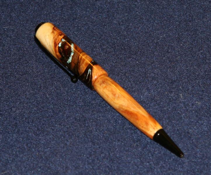

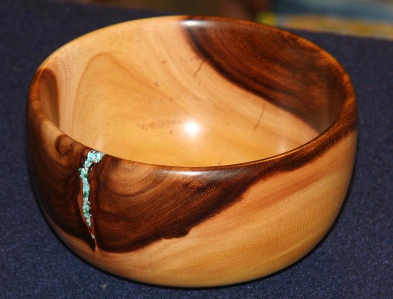

Try this. Open up the crack wider and fill it with turquoise, jasper, hematite, or some other crushed stone.
Crush the stone into a combination of small chips and powder (I put about a teaspoon of chips into the cut off finger of a nitrile glove and beat it with a hammer on an anvil!)
I use a dremel with a dental drill, but you could use any small bit.
Turn your piece until it is almost finished size. Open up the crack or hole with the dremel (all the way to the brass on a pen) Pinch up some of the chips and drop them in the crack and add a drop of thin CA. If it is a deep crack, like in a bowl, build up layers of chips and CA. When you are a little above the surface of the wood, add a pinch of the powdered stone to fill in the area around the larger chips and add another drop of thin CA.
Put it on the lathe and spin it. While spinning give it a short blast of accelerator.
I use a Pen Pro to turn the stone down flush with the wood, but you can also do it with coarse sandpaper. Sand the infill smooth and examine it for voids in the stone. If you have small holes, put a drop of medium CA on the hole and rub in a bit of the powdered stone. Turn it smooth again and re check for voids. When it is all filled, sand and finish as you normally would. I use about 12 coats of CA/BLO, until the area with the infill is completely smooth and you cannot feel any roughness there.
