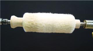

....I have a very thick and fluffy paint roller I put on the lathe to buff the wax with......
Ben
Hmmmm, never thought of using that.. cool idea.. so how did you mount it?

Here 'tiz. Make a plug for each end and hold it between centers. This one can be held in either a chuck or between centers.

DSallee,
You can do what Russ has shown, or, I purchased a set of delrin bushings from Bruce Boone. They work great.
Ben
