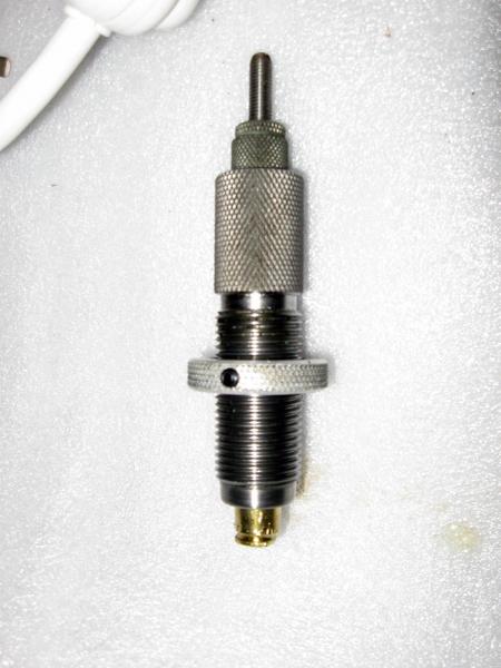

First off, I use to reload cartridges with dad and brothers when I was a kid in the '50's. I have long since forgotten any thing I knew about. I do have some equipment, a press, dies, that I have saved over the years, just in case. Anyway, here is my dilemma. Today I wanted to remove the primers and re-size some cases to make a few pens (I don't know if I am using the correct terms). I put the die in the press and the first cartridge went as I thought it should. The second and third not so good. I couldn't press the cartridges in far enough to have it eject the primer like it did the first one. Coarse I reefed on the third one and now the cartridge is stuck in the die. Any suggestions on how to get the cartridge out? It pulled out of the seat that the end of the cartridge slides into on the press.

The cartridges are 270. the press is an old Herter's I think. The dies are RCBS. The die I used is the one that has the pin/rod sticking out that pushes out the primer. And,yes I did forget the lub. I should know better. I tried to unscrew the top piece that the rod is attached to and you can adjust the depth with, but it only comes loose out so far. Feels like the is ridge or nut or something in there to prevent it from coming all the way out.

With RCBS rifle sizing dies the de-priming rod comes out thru the bottom. It can't come out the top because of the expanding button.
There's several things you can do.
1. RCBS sells a stuck case removal tool. You drill and tap the primer pocket then pull the case out with a bolt and spacer. You can also make your own. If it's really stuck you'll strip out the threads.
Sounds strange but the next two methods are extreme opposites.
2. Put the die in the freezer for several hours or over night. Put the die in the press from the top upside down (case sticking up). Then grab onto the brass with a channel locks and twist. If you can get it to move it will come out.
3. The most extreme and last resort. Heat the DIE up with a propane torch. Do not heat the brass. I've had to result to this a few times and it works. The die will not get hot enough to harm the die.
If you try these and still have problems PM me.

No matter what the brand, the decapping pin is not going to come out the top of a bottleneck rifle sizing die. The expander ball is larger in diameter than the interior of the case neck in the die.

Again thanks for the input. Using the extractor method I was able to remove the cartridge. Use a socket with a bolt method. Lesson learned: CLEAN and LUBRICATE!!
