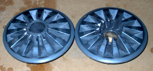

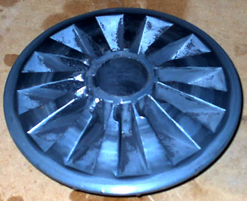

While replacing the bearings on my Jet 1236, I was checking the reeves pulleys and noticed that the inside of the veins appeared to be worn, just under where the belt rides. I assume this should not be like this.
Also, the half that was on the outside was very difficult to remove, had to resort to gently tapping it with a dead blow rubber mallet and rotating it to get it off. The half on the inside slid right off and does not even come close to being a tight fit. Should these be replaces while I've got the lathe apart?

Monte- how does the shaft look? Ridges? Shallow or fairly deep? How about the center of the pulley, is it gouged much. If they look good & the faces come together they should be ok. Grease them up good & get the outer one to slide easy by hand. I've got an older Grizzly G1495 & replaced them & motor last year. A bearcat to get to, & almost impossible to lubricate in the cabinet. Actually a sey of pulleys are pretty cheap.

Richard, the shaft looks fine, just a little surface galling, I'll remove that and polish with emery or crocus cloth.
The wearing on the pulleys is just below where the belt rides when they are at their farthest position. I'm thinking the wear was caused by the fact that the inside half was wobbling on the shaft, even the key slot was slightly larger then it should be.
I figured since I already had it apart to replace the bearings, I might as well replace both of the pulley halves. This will also keep the bad half from damaging the shaft. Hopefully I'll have the bearings and pulley in by the weekend so I can get the lathe back together.

Mannie: Do both the drive pulley (motor) and the driven pulley (HS) show wear? If you are going to replace one, might be just as well to replace both??
:redface:Duh.... I musta had a blond moment.:embarrassed:
Didn't even think to check the drive pulley. Just went out and looked and it does show slight wear, but nowhere near what the other one shows.
It's a moot point now anyway as I ordered the ones for the HS yesterday.
