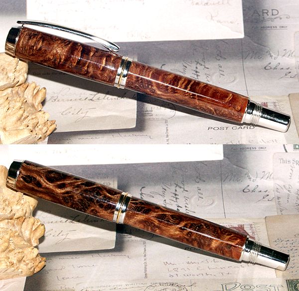

I have done some real nice pens from redwood burl.. it finishes beautifully... but as you noticed it is soft. It also absorbs BLO like a sponge and will take some time for the BLO to dry, a lot longer than most other blanks... If you are using BLO on these blanks let them dry for a couple of days before applying your topcoat finish... The BLO will pop the grain of redwood burl and give it a real nice look... Here is a pic of some lace redwood burl I did with BLO
<b>Lace Redwood Burl Platinum Jr Gentleman</b><br />
