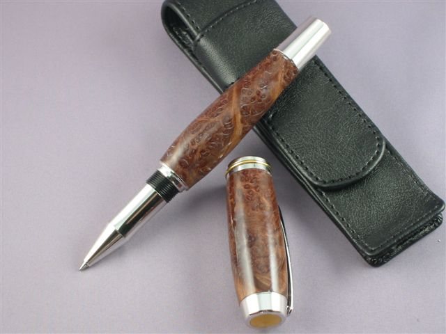

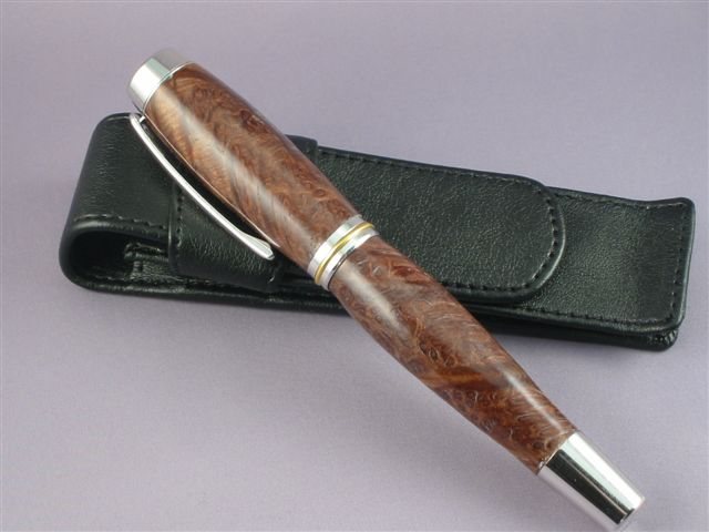

Hi,
I am not sure why, but redwood burls I and I do not get along at all. This was a bear of a blank to finish even though it's a stabilized blank. I had so many problems with it crumbling and not staying together...it's my last.
Any one else have a similar problem with this woo
d?

Jim, I've only done one Redwood burl and I attempted to stabilize it myself. It didn't appear to take up any of the solution, but it turned and finished well. Is the crackled look a result of what you are referring to? I think it looks kind of cool.
