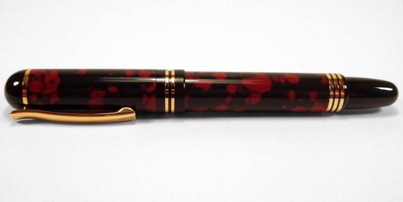

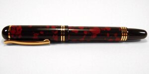

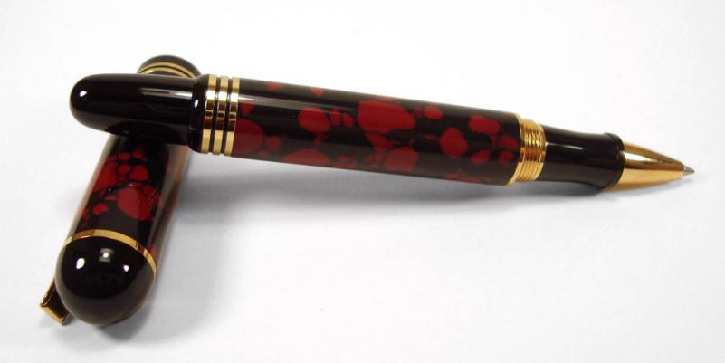

From what I have noticed on the forum, Churchills always turn out looking great with blanks that have a lot of black on them. When I saw this blank, I knew I had to put it on a Churchill and now that it's all together, I think it was the right choice. I am really happy with this one.
