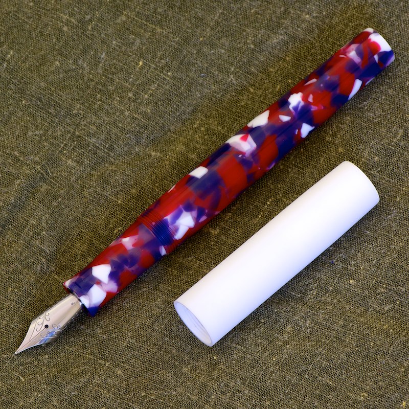

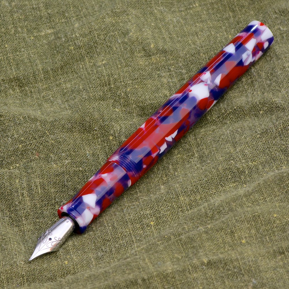

I finished this one up to this stage before I locked up the shed this afternoon. Some red white and blue chip resin I got in a blank swap a few years ago.
14mm double start threads for the cap, the section is 12/13mm diameter, pen is 140mm overall length. it has a #6 Jowo F fitted at the moment.
I don't have anymore of this material, so the cap will be made from something different.
I was thinking black Ebonite, but it could be a nice piece of timber, or even aluminium.
Waiting on inspiration. It will come.

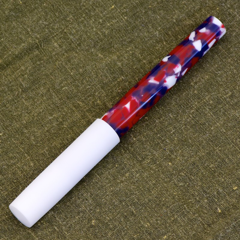

I found a rod of similar whiteness in a drawer, so I have gone with that. Turned down to 16mm, which is as thin as I dare go with the 14mm thread.
The cap still needs to be sanded and polished, this is straight off the tool.
The section needs a polish as well, I had to take 1/2mm off the nib-end diameter as it was rubbing inside the cap.
I am going to try a new style of clip, if that doesn't work, it will get one the same as my previous pens. But that will have to wait at least a week now, work beckons.
Hello Brad, that is a beautiful pen, but I'm sorry to state. That in my personal opinion, the cap doesn't do a thing for the body. Oh yes, I'm sorry it does, it ruins the looks of what could have been a gorgeous pen. Once again, I'm sorry if you think this is a harsh statement mate, it's only my personal feelings on the plain white pen cap mated to a gorgeous pen body.
Len
Thanks for the honest feedback Len.
I agree the cap is too plain for the pen, I am hoping that with a clip fitted ,it might lift it enough. I will wait and see before making a new cap.
