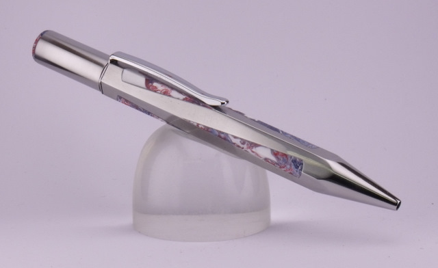

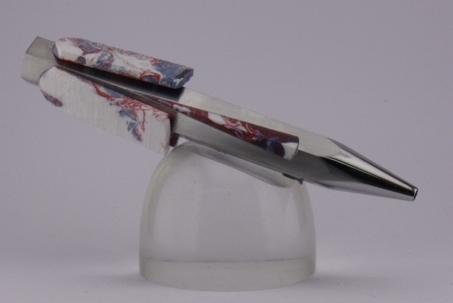

This little pen is has six segments of red white and blue pr cut into the corners of the stainless hexagon and a little button of it on the mech finial. The pr was just left overs from the very first pr I mixed a while back. Only the surface of the pr had the colours as the red and blue floated to the surface. Donor clip ( Sierra I think? ) The second pic just shows how the bits are fitted.
Hope you like, and comments and critiques welcome:biggrin:

I'd love more details on construction. Did you grind the triangular holes out of a piece of hex stainless, or did you bed the PR and then grind the whole lot hex?
PS - I'm nearly finished my first gallon of resin and I've made one PR pen so far.
I was wondereing if you would be so kind as to give us mere mortals a brief explanation on the execution of said pen??? If you have trade secrets I do understand and will accept that as an answer. Thanks for showing.
It's a beauty.
LOL, I don't want to sound big headed, but this was not difficult to make.
1. Take a length of stainless hex rod.
2. Drill a small hole for the nib as about 20mm deep in one end.
3. Drill a 7mm hole in the other end using a long bit.
4. Thread the end to accept a mech
5. Shape the front.
6. Sand the sides of the hex to get rid of the rough surface ( Lots!!)
7. Polish the steel.
8. With an end mill in the lathe and the pen in the toolpost, cut the notches. Slight angle on the tool post.
9. Cut 6 bits of pr and round the one end of each to match the notch
10. Glue in 3 bits of pr in one end and sand flush with steel.
11 Glue in the other 3 bits and sand again.
12. Make a sleeve for the mech.
13. Polish it a bit
Done:biggrin:
