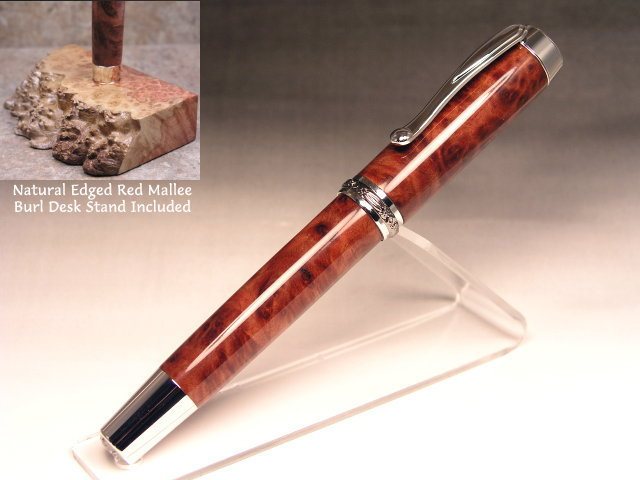

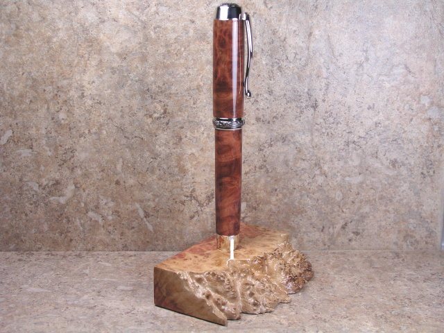

I made a simple natural burl edge desk stand for a Statesman that I made recently. Never throw away your scraps!

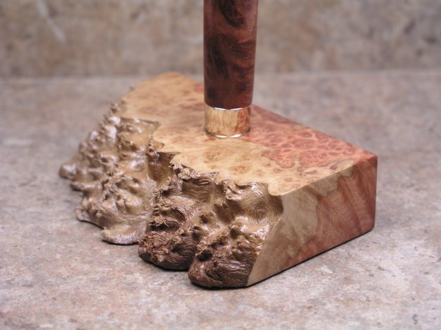

Yet another beauty! Did you use a funnel in the base? If so, where did you get it? It looks like there's a metal ring in there somewhere, but with your finishes, it may just be a reflection!

<br />Yet another beauty! Did you use a funnel in the base? If so, where did you get it? It looks like there's a metal ring in there somewhere, but with your finishes, it may just be a reflection!
Thanks for all of the kind words.
Jim. I make the rings myself. The tubes for the El grande / Churchhill are a nice fit. The trick is using both of them. I drill the base to the larger diameter tube. Then I step drill the hole down a bit to the smaller diameter tube. So there are actually two contact points in the hole. The very tip, and then up higher on the metal finial. Makes for a very solid and precise fit. You have to get your measurements right before you cut the rings for the lower, smaller tube, but the larger is just trimmed, or sanded flush once installed.
Cheers,
Fangar
Fangar, I'm confused.....do you mean that the small ring we can see, at the surface of the burl, is a piece of a larger pen tube? It looks silver not copper colored??
I don't think I'm following this ...
-Max
Originally posted by Max
<br />Fangar, I'm confused.....do you mean that the small ring we can see, at the surface of the burl, is a piece of a larger pen tube? It looks silver not copper colored??
-Max
Max,
I will take a couple of better photos when I get a chance, but in all actuallity what you are seeing is more of a replective glare from the finish on the base and the joint to the finial. Anyway, it is a brass tube in there. When the pen is in place, it is not really visible.
Fangar
OK, that makes sense...very, very clever idea!!
Thanks for explaining it..
-Max
