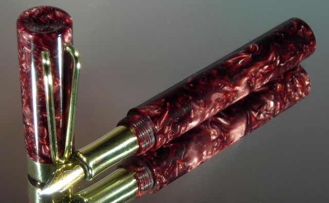

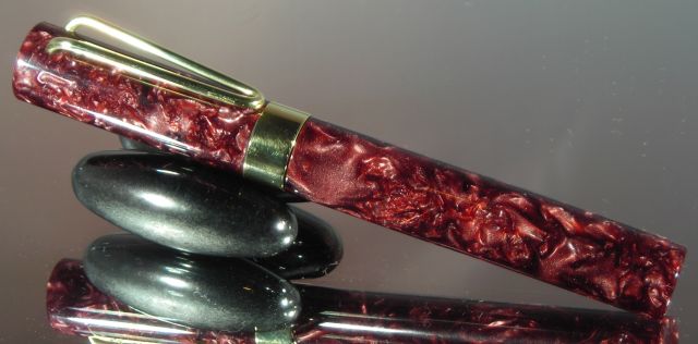

This is a kitless FP made from a Red crushed velvet blank and Brass . I used a Baron feed and holder with a brass front section and one of Lou's Steel flex nibs . The center band is a piece of a Majestic upper brass tube .
This is a slender pen measuring just over 1/2" thick . My wife says it looks like a long lipstick so we started calling this the lipstick pen .
I love these crushed velvet blanks , they look kind of like an acrylic burl . I just wish they were bigger , they are only a little over 5/8" square .
As always comments are welcome .
Butch, you've peaked man. Quit now while you're ahead! Seriously that is a very nice pen. Well done. My only comment would be to make the center band thinner. Love the clip.
Another beautiful pen, Butch. I agree with Keith, a thinner center band would look a little better. Just a suggest from one who can't do what you do so take it for what it is worth.

BEAUTIFUL job!!!!
Hi Butch greta pen looks fantastic and you may be able to answer a question for me.What method do you use to drill the blanks as i have had a couple of acrylester blanks shatter on me recently
Murphy101 Ireland
I am always astonished to see your work. It always makes me think differently about what I am doing and how one would accomplish what you do. This pen is beautiful, the blank has a nice textural sense to it with multi dimensions. I like the band as it is presently and it all flows well. Thanks for sharing it.:wink:
Gee everyone I'm blushing :embarrassed: , thanks for all the kind words . This pen is gone :crying: The LOML took one look at it and she won't give it back , and it's not even purple !!!

Keith and Paul ,
I made the CB wide to help with the lines of the pen , because these blanks are so thin (turned round they are only a hair over 5/8" and after final sanding the pen is just a little over 1/2" thick) I wanted to give the overall pen a little bit larger look and I think the wider CB does that .
