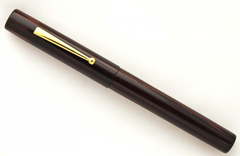

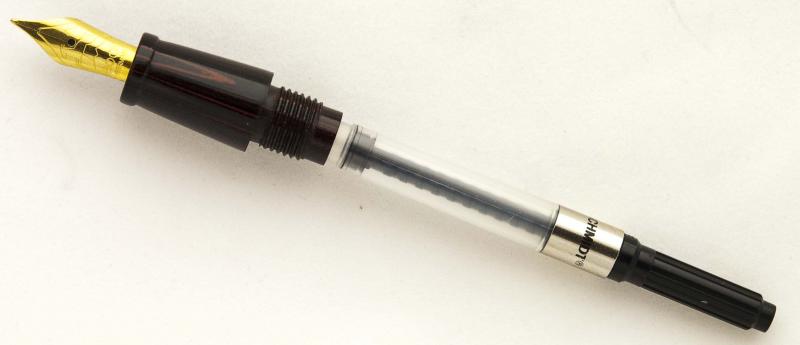

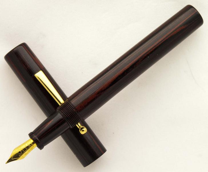

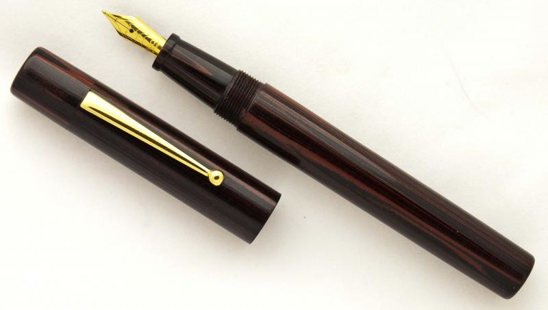

Made it over the course of a few AM's and just finished it this morning/afternoon:rolleyes:. It's made out of Red and Black Ebonite and has a #5 Fine Bock nib. Just like smaller nibs... but in retrospect.... wish I would have gone with a #6 nib. It was hard to photograph and bring out the red striations in the ebonite. Anyway..still have a lot to learn.... Almost screwed up the section :eek:...so I texted my Sensei and got back on track..Thanks Justin!!:smile:. Hope you like it. Doc :smile:

Well done Grasshopper!!!!Looks like your best yet......Very proud sensei here.....im glad we could get you back on track.......now if we can just get you doing things forward rather than in reverse :)
Beautiful, Doc!!! I agree with Jason , excellent job of threading. What size taps did you use for section to bbl and cap to section? If you don't mind me asking. Those are really nice! AND you had to get the jump on me on the clip, didn't you!!:rolleyes: :biggrin: joe
Beautiful pen Doc. I really like the red stripe or Cumberland Ebonite, this red stripe actually looks better than the Cumberland rod.
And what a beautiful job of threading the section, I still haven't had the stones to try and do one yet.
Doc it looks really good. Personal preference here and not picking at all, but I am not sure I like the distance of the cap finial. I think I would shorten the distance from the top of the clip to the top of the cap. The way you have it makes it look extra long when I am sure it is not any longer than any other standard pen. I think your section and the threading look just fine.

Thanks Joe !! I used the 14 MM triple start set (tap and die) for tapping threads on the inside of the cap and threading the outer body. I used a 10 mm tap and die to cut the threads on the inside of the body for the section whose threads I cut with the 10 MM die. Regards, Doc
Mike, Thanks for the input. As a matter of personal preference, I like it as is. It is actually as long as it looks! Doc
Mike, This picture below may give you an idea of the size of the pen and the reason I picked the proportions and distances. I centered the clip so it would sit right between the top of the finial and bottom edge of the cap. It is a larger pen and in the picture I compared with two pens from my collection. It's a Pelikan on the right and a Bexley on the left.
Regards, Doc:smile:
