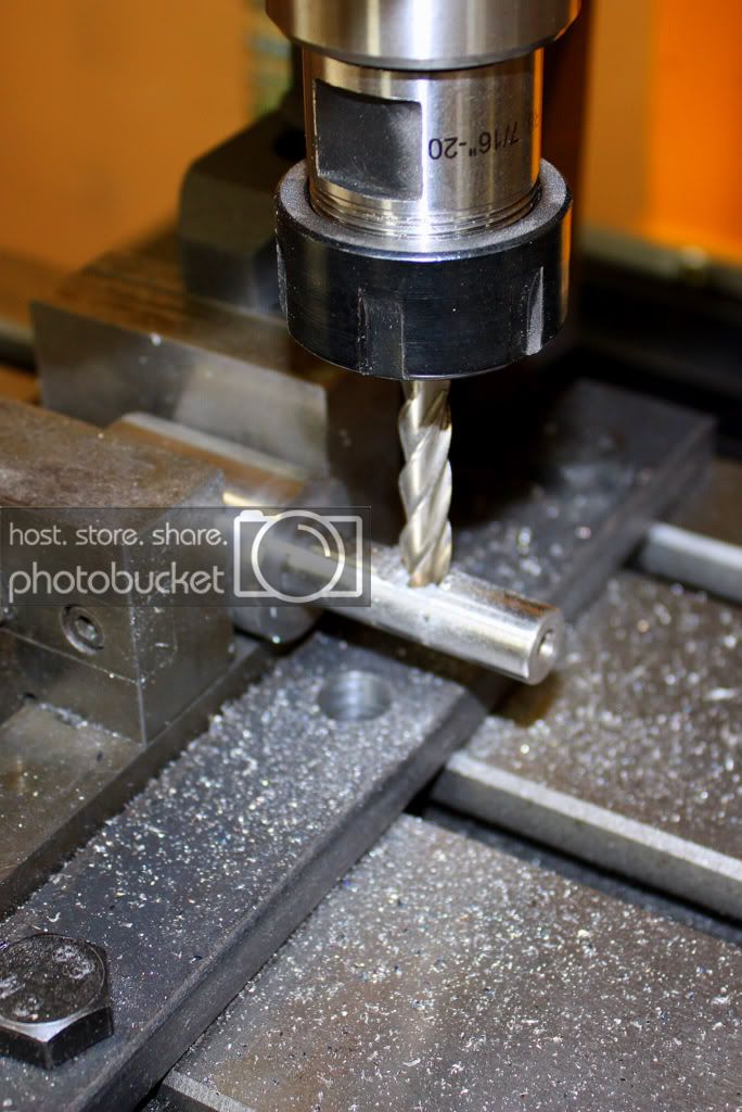

Milled a flat on it

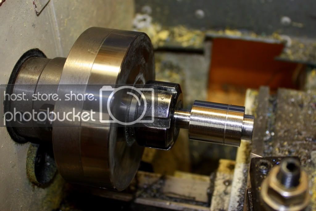

Turned a tenon to to fit in the slitting saw
