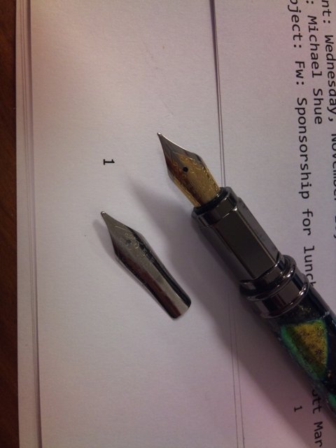

my kid started with a mag vertex fountain and loved it...until I made him a full sized pen with a GOOD nib. The mag vertex feed won't accept different nibs ??????? anybody?..... but was a good "starter"
I just pulled one apart. It looks like the #5 nib on everything else, but I can't get the one out of my baron right now to double check. Why do you say it won't take different nibs?
edit. Okay, got the Baron apart so here is a pic of my Dichro Vertex with a two-tone Baron nib and the original all silver nib next to it. I've inked it and it's writing fine.
