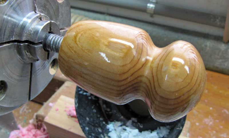

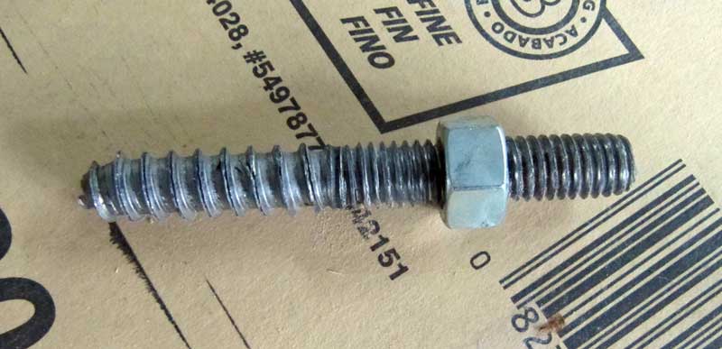

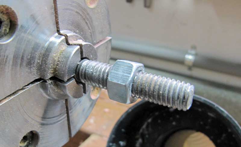

Here is how I turn my brush handles. A cheap 3/8" hanger bolt and a nut, I used a hanger bolt because I had some a regular 3/8 bolt with the head cut off might be better. i use my 4 jaw chuck but it would work in a collet chuck or a drill chuck.
Drill the hole for the brush head, change bits to a letter O and drill and drill an inch or more deeper, thread with a 3/8x16 tap and screw the mandrel in.
Brilliant! Easy! Thanks. I'll give that a shot. I can use my Jacob's chuck for it (less knuckle mangling that way!).
