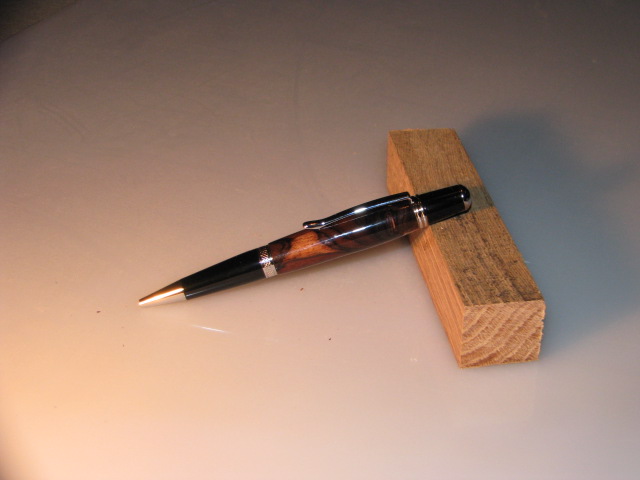

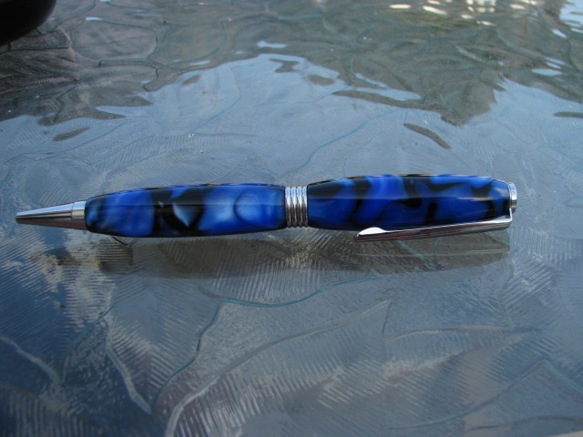

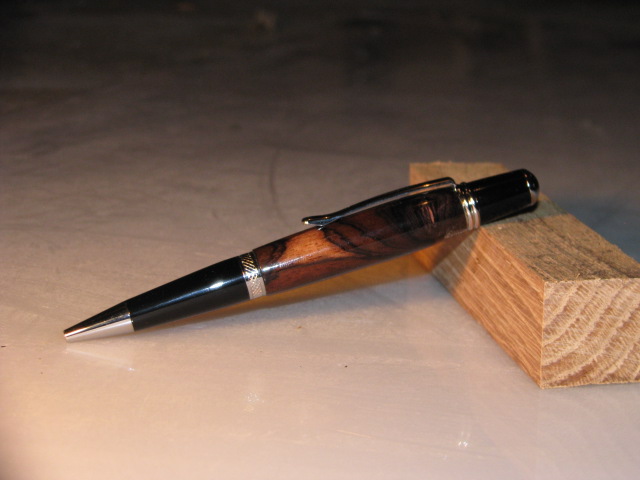

Ok so here is my 7th & 8th pen.
- Blue acrylic Chrome Streamline Pen.

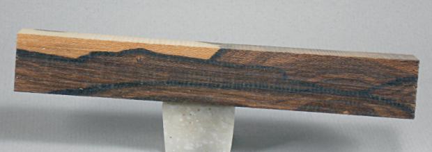

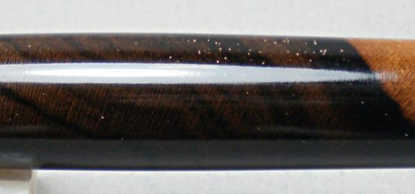

- Chrome Sierra Pen. ( I thought I was buying Indian ebony, but when I started to turn it I realized its not black through-out. If any one knows what this is please let me know. Not upset looks good I think and I'm happy with it, just have no idea how to describe it, lol)
Sorry for the bad pics, still learning this Cannon Powershot s5 and I dont have a close up lens.

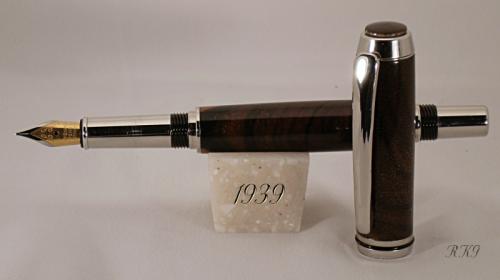

Look good from here, I would bet the wood is Ziricote. Here's one of my pens in Ziricote. You can just see a bit of the lighter sapwood on the top and bottom by the nib end.

Hi Rick
Both pens look great! I have a piece of macassar ebony in front of
me and they look very much alike.
Thanks Tim
I believe Tim is correct - Macassar Ebony. This can have quite a bit more sap wood in general.
One question is - how difficult was it to drill? And what was the texture of shavings as you turned.
The light color is sapwood indicating this wood was cllose the the center of the tree.
It is a beautiful piece of wood and you did a great job with both pens!

I love the background on the first pen. Is that just a piece of glass? Water?
Its just my patio table, glass top with a leaf design on it.
It was pretty dense I really had to take my time to drill. The turning came off in really small pieces it felt like I was just chipping away at it, the chips that came off were almost like tiny triangles. Definatly a slower process than normal.
I think you are right with Macassar Ebony.
Good job with the pens.

Noticed that your Sierra pen has a bit of over hang (oversized) where it meets the nib section.
Did you use bushings or turn it freehand?
To get that joint to be perfect (.475" diameter) it takes a true running mandrel, a steady hand, and sometimes a bit of good luck.
Nice thing about the Sierra pens is that they can be taken apart fairly easily and redone till they are perfect.
Good work ... Keep turning and I bet you will be very popular come Christmas time.
Yes I did use Bushings. I am slowly working my way closer and closer to them. I am trying to figure out just how much I should leave to accomidate for sanding. Apperatly it is not much.:smile: Thank you for the insight as well.
