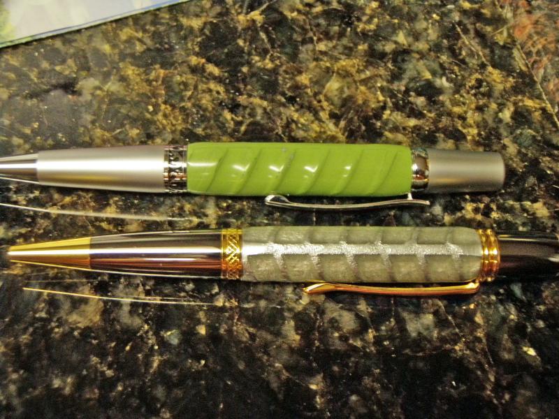

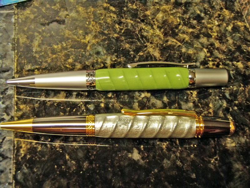

Jerry's Rebar blanks from Exotic. I told Dawn that I would post them up in new colors. The Green Epoxy is the coating currently used in bridge decks across the country where salt penetration is a problem. This is the actual coating used. The Chrome bar represents the Stainless bars used in extreme conditions where corrosion runs rampant. I used Rustoleum Chrome spray paint for this. Both blanks were jigged in a small 4 RPM motor and turned while applying Devcon 2 Ton clear epoxy. Makes for a little smoother blank and won't catch on microfiber cloth. The green epoxy was placed on a Elegant Sierra while the Chrome model was placed on a Diplomat black tn.
The quality of the rebar blanks is A-1 as one would expect with a collabration between Exotic Blanks and Jerry Sambrook. Nice Work Jerry!!
