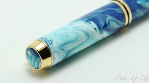

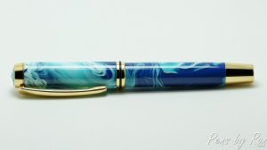

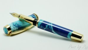

I am really having fun with replacing the final in pens. Here is another one I finished recently. It is a nice change to do something different. I am considering a closed end pen next. Its fun to find a new way to keep this hobby exciting. Maybe Kitless after that. ;)
Thanks for looking...
It looks like a Timberbits Junior Gent to me.
If it is how do you get the original finial "Gem" out? Press it out or "Bonk" it out?
It really adds a lot to this already beautiful pen.

Looks great! And yes, a custom finial that matches the blank material adds that little something extra that sets it apart from others.
Wow. Thanks for all the nice comments.
This is a Jr Gent II kit. I used a center punch to get the finial out. On the first one I did I had drill it out a bit as well.

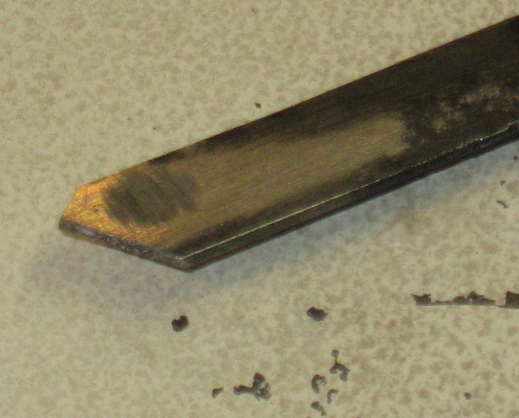

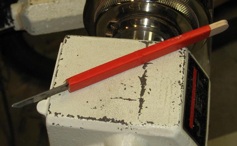

I made my mini parting tool out of a metal cutting jig saw blade. Ruffed up the surface and CA'd between two popsicle stick which I warpped in red duck tape...
