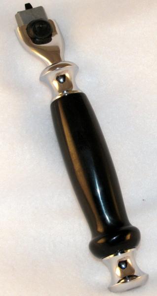

I ordered some razor kits online, and the supplier forgot to ship my bushings. I'm sure they will fix it and get some out to me, but I'm eager to try a razor.
Can anyone tell me the bushing dimensions? I've got a bit of Corian that I might be able to re-purpose.

Not critical dimension
Hey Peter!
When you make the razor, the dimensions are not critical. The components are rounded, so you can round your handle to meet them and it looks "right", I think. Here is a pic that I hope will make this a lttle clearer:
Feel free to ask questions!!

I did mine without any bushings. I just inserted my dead center and live center directly into the tubes and turned away. Then used calipers for final sizing.
Same here. There is so much "meat" on a razor that you can turn to the shape you want, then pop it into the collet chuck and drill the hole.
