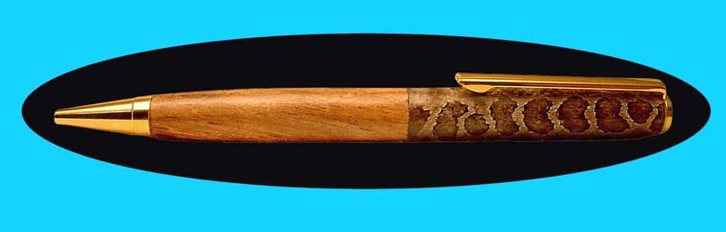

Take a look at rattlesnake skin embedded in polyester resin with a spalted pecan bottom. This was inspired by the blanks made by The Baldwin Bros and sold (at one time??) by Ryan at woodturningz. A good friend and fellow penturner Jay Pickens introduced me to PR. It is fun, give it a try.

Hey Don,
That is a great looking pen! I like using the wood for half of it, and the color of the Pecan seems to go nicely with the rattlesnake. Very Nice!
Scott.
Don,
That's an outstanding pen! Nice simple lines supporting the snake skin. I'm glad there's no center band, as that would have detracted from the smooth lines.
Bob S.
I was also wondering about the seam, but I have another technical questions.
Once the tube is emersed in the PR, do you end up redrilling the inside of the brass tube to get the resin out, or is the tube plugged in some fashion. Great pen. I see lots of possibilites with PR.
-Nick

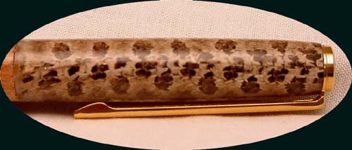

Originally posted by RussFairfield
<br />How do you disguise the joint in the skin?? Or, is the photo always of the "good" side??
Russ,
I just glue the skin and overlap one edge over the other at the seam. It tends to blend end very nicely. I did take the picture of the non-seam side which has the nicer skin pattern. Attached is a photo of the seam side. See what you think.
Do a good turn daily!
Don

Nick,
I use cork stoppers to plug the ends of the tubes to keep out the PR and use the corks to help suspend the tubes away from the bottom surface of the mold. I sketch my mold set-up, scan it in and post it later today. If you are a member of yahoo penturners there is an excellent article on casting PR resin in the files area in the 1A Reference folder. It was written by Jay Pickens and is a excellent resource.
I addressed the seam in a previous post in reply to Russ's post.
Don
