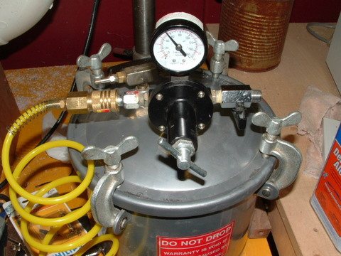

I cast my own snake blanks as do several others here. You can see how I do them here: http://content.penturners.org/articles/2006/snakeskinblanks.pdf

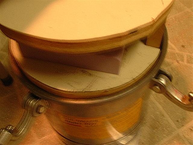

I have been looking over the pdf file, very informative indeed. I was wondering about the cork. would it not be better/easier to pack the tubes with play dough or modeling clay then just put the whole things under the vacuum?
I was looking at the tank and thought a 4" PVC pipe should work (will just be doing a few blanks at a time.

Using corks have been the only way I can keep the resin from getting inside the tubes during pressure casting. Note that only the resin is sujected to the vacuum, not the entire casting with the skin etal. I've (and others) have worked diligently to develop a method of casting these skin blanks. But, we are always ready to learn a better way, so if you try other ways of doing this and find something better then please share it with us. I have not tried any other pressure or vacuum vessel...I will stick with my paint tank. Let us know when you find an easier way of doing this. Good luck.

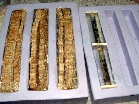

Don't know if PVC would work with snake. I just don't know if you could center the tube properly or if you would have enough open space to dissapate the air bubbles, but as Don said if you are successful let us know. I just cast some snake and cactus and the pictures are not the greatest but maybe this will help you.
