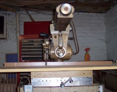

I've got an old Craftsman 113.29003 saw that I don't use anymore. I know it can be set up as a router,molder,drill,and sander. Is there anywhere to find the chuck for this? The best I can find the saw was made in early 1959. It may be a bad idea anyway, but it seems like a good use for a great tool.

The manual for the saw ( http://www.hammerwall.com/Download_Manual/44301/ - just enter the captcha and it will give you a link to a .PDF) says the shaft thread on the back side of the motor is 1/2"-20. Any drill chuck with that internal thread should work.
Thanks. The manual I have didn't give the shaft size, and the owner wasn't smart enough to look at that end of the shaft.
The radial arm saw does make a pretty good horizontal boring machine. I just checked mine (bought in 1975), and it is a 1/2-20 thread. I refurbished my RAS a few years ago -- mostly a tuneup, alignment, and a new larger top with melamine surface. It is my most used saw, more so that my table saw, bandsaw, or compound miter saw. It is strictly for 90 degree crosscuts, where it excels. But I used it for many years for rips, miters, compound cuts, etc. I bought the molding head cutter, but never really used it, since I bought a router a few years later. I also have a picture frame type of miter attachment, and some hold down clamps I never use, if you are looking for these types of accessories.
