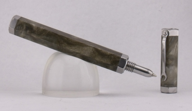

Warning!!! This is a quick and ugly pen:biggrin:

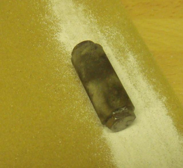

Every now and then I get a crazy urge to go back and make a pen from a bolt or two. I used a lathe to drill the holes for the refill, but the rest was done with several sheets of sandpaper. I have no fingerprints left.:biggrin:
Made with two 8mm nuts and two 8mm bolts (stainless of course:tongue:) and a bit of PR. The PR is a bit more 'Pearly Brown' than the pics suggest.
Just a bit of fun really.:rolleyes:
Edit; Just knocked up a little spanner clip for it.

Dean, you really don't need a metal lathe for something so basic. If your wood lathe is aligned true enough for drilling, then you are good to go. The pointy bit at the front was done with files.

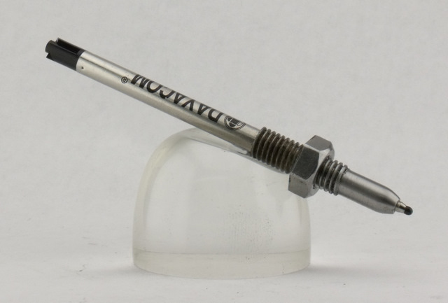

I'm not sure how close 8mm is to Imperial, but there isn't much left in the threaded section once the hole is drilled. Look at the first two pics and you can see what I mean. I used a 5.9mm drill for the refill. If it was a rollerball refill then it would have been too big as I think the smallest you can use is around 6 point something. I use a 2.6mm for the tip of the refill.
Making sure the hex flats are aligned once the cap is on is easy. Just try a couple of nuts on the same bit of thread different ways around till you find the combo that mates nicely. :biggrin:

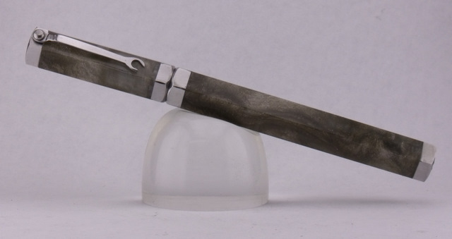

Just added a little spanner clip to it. It's fixed on with a SS Hammer Rivet:biggrin:
the clip sends it over the top! I can tell you of several mechanics that would flip out over such an ink pen! I hope you dont mind, but i plan to attempt to copy this design! that os so freaking cool.
