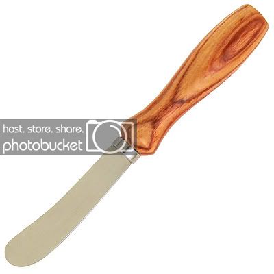

Does anyone know of a tutorial or video on making a rolling pin?
also i have the following kit and i would love to make these up but i dont know how to turn them or assemble them any help?
For the knife -
http://www.woodturnerscatalog.com/woodturners/Images/pdfs/cutlery.pdf
