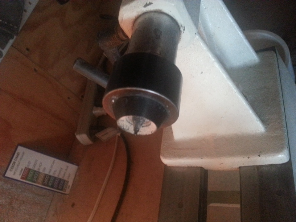

I've been reading about "Turning Between Centers" here and it looks like a much better way to turn pens. A few questions.
1. Can I use any of the bushings I've ordered or do I have to find TBC bushings?
2. Centers...what do I need?
3, Can I use the center I already have on the tail? ( in the attached picture )
To answer your first question, yes you can use the bushings you purchased with your pen kits. That said, many of these bushings are not made with great accuracy so you should also be using a mic or calipers to verify the measurements when you get close to the bushing. Also, the bushings that are sold with most pen kits are made from rather soft metal and they can/will contaminate some woods with metal dust if you sand down over the bushing. The TBC bushings I have are milled to much more specifiv specs and in fact pop when you remove them from the tubes. They are also made from hard steel so they last much longer and are much less likely to contaminate your almost finished pen blanks. You might be able to get away with the center you show in the photo, however, you really should have a 60 live center on your tail stock and a 60 degree dead center on your head stock for TBC. You can usually shop around here on IAP for some of the vendors that sell TBC bushings. They are worth every penny.

Thanks guys! I found both the dead center and the live center on Amazon. I am going to do this!
