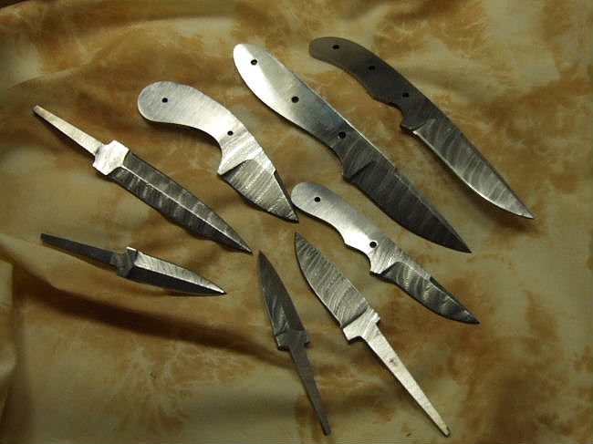

Yep, a plasma cutter is on my list, unfortunately, it is a long list. I have 6 damascus blades sitting in my to do bin for a couple of months now. [:(!]
Don, they are ready to go, cut, sharpened & polished. I just need to find the time to make the handles.
OOps, I guess I have 8 to make [:D]
