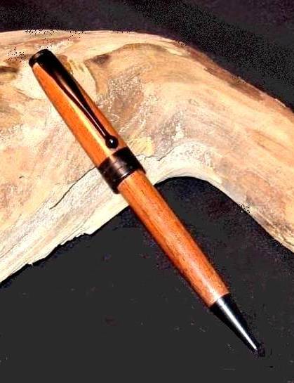

I have to agree with both Lou and Vick... The following pics are actually of Russlines I make all the time:
The top barrel is 3/32" longer than the stock tube. I cut it from a 10" tube from Woodturningz. Top is 7/16" in diameter.

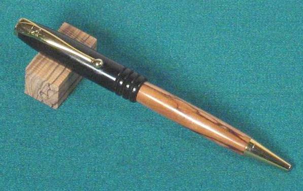

Walnut with blackwood accent. Same 7/16" diameter in the top barrel.
<br />
I might make a steel bushing with both sizes when I have time. In the past I have used the regular 7mm bushing, and just measure the top with my calipers to 7/16".

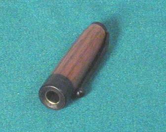

In this image you can see that I have made a recess in the bottom of the top barrel. It is like a very shallow countersink. I cut the top of the bottom barrel a bit to match. This hides the joint.
