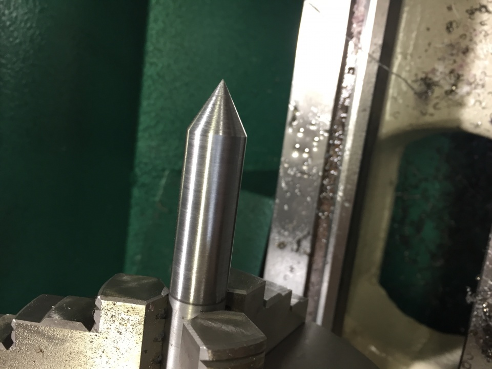

Where would I order a straight dead center?

Straight dead centers are not very easy to come buy .... you might find at KBCTools
A machinist friend made me one.
A good alternative is a diamond sharpening cone from Lee Valley Tools.

You have a metal lathe, make you a straight dead center. I used a 2 1/2" piece of 1/2" mild steel rod. Set your compound to 60 deg. and make passes until it makes a point. I just use a file to reestablish the taper if I accidently catch it with my chisel when turning. You could use O1 or drill rod and heat treat it after turning if you want something more "maintenance free". Takes all of 15 minutes to make one. Mine works for wood and acrylic blanks without the need for spurs, just clamp a little tighter if it free spins.
I marked mine before turning so I could put it back in the chuck in the same orientation each time. Guaranteed to be centered w/o run out.

I got home late from work and ran right out to the shop. I didn't have anything to turn this with so I stopped at the BORG hoping they had a little cold rolled, but they didn't so I got a 3/4 threaded rod. Not knowing but hoping it was hard, I just figured it was harder than pen blanks. I turned the threads off it and figured out how to get a 60 degree angle and did it....it was really easy.
I take it you marked yours by marking where a given chuck jaw goes, I read they were numbered for assembly somewhere.
It was funny because I was in such a hurry I never checked the site and just ran right out there, then saw your post after I was done. Is there anything else I should make while I'm at it?

Sorry the photo is not oriented the right way.....In Photoshop bridge it is the right way, so I didn't know how to fix it.....but I think you get the idea...

Great looking dead center!
