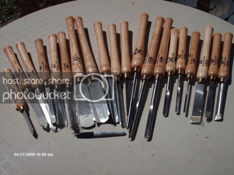

I think I'm covered no matter which tool it requires.
I don't have them all, but I have a few laying around. :smile:
Herb, nice set of tools. Not sure if these are the tools you have been using or not but it takes some practice to use short tools like that. It is a different movement than using long handled and long shaft tools. I prefer the longer ones but use small tools for fine details. With shorter tools it is hard to have your elbow locked against your body and relax. Seems like you are always reaching over the lathe and for me it makes for an unsteady tool and harder to control. Especially the skew. Those are some short skews. Not much left to sharpen in the future. Good luck and no excuse for not getting things turned. :smile:
Those are all full size tools. The table they are sitting on is 4' in diameter.
Notice the Sharpie in the front for scale. That's a full size pencil on the left too.
Look at the shaft of the spindle gouges as compared to the skews. . But photos can be deceiving :biggrin: Have no idea what brand they are. Just not use to using that short of tools. Good luck with your turning adventures and have some fun.
They are all Benjamin's Best from PSI. I got a gift certificate for them when I first got into wood turning. I used it to stock up on all kinds of tools. Some are detailing tools.
Granted, some I haven't used yet. But I have them in case I need them.
