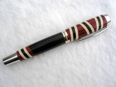

Jim here's a pic of a custom order I did...athough she ordered it with m ore Blackwood than Holly you can get an idea.
Oh BTW Ed who said anything about sanding....I use a sharp skew to turn pens....lol
Seriously Jim if you go this route finish turn it as smooth as possible and seal with thin CA before attempting to sand.

I had begun to wonder if CA between sanding would prevent colors from running
Oh, Jim, (said in "off-hand voice")
If you seal the bloodwood with CA, you will seal in all the scratches. IF you can make a "finish pass" with the skew as Mike suggests, all is well --- I have NEVER been happy with MY attempts.

how thick are those samples?
and if at nearly 8K posts you still have "minimal skills", I just may have to quit now!
well, if I didn't enjoy it so much :biggrin:
Samples are half an inch thick and can be combined with CA, making an inch. Have done it many times.

Jim, if you're very careful you can seal the Holly and still be able to sand any scratches out of the Bloodwood
