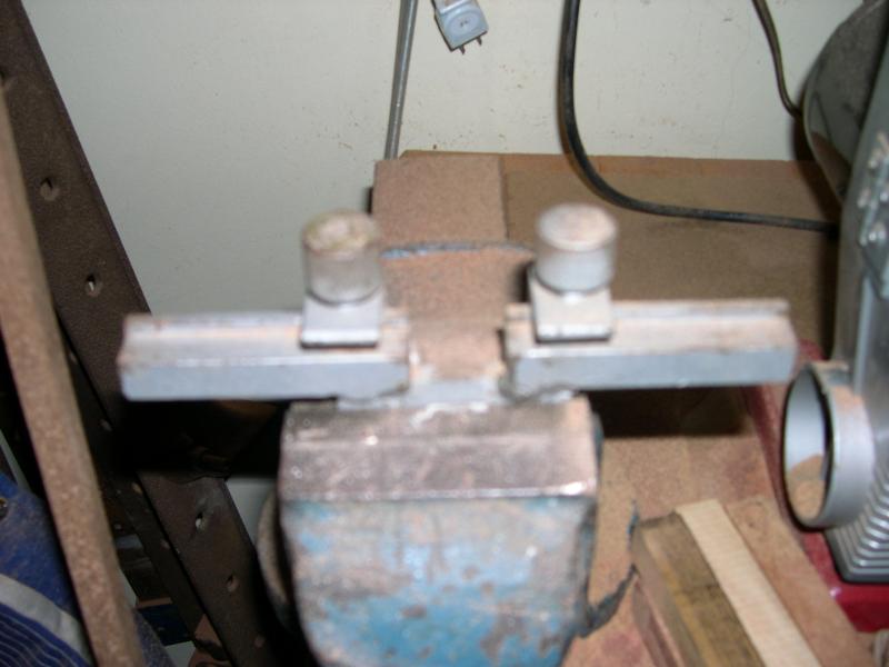

Regarding Bandsaw blade brazing, I was taught to use the jig, which I had made for me, by a guy who was employed and served his apprenticeship, with Rolls Royce in Shrewsbury UK, and it has served me well in the UK., I took a close up of it, for anyone interested. The two ends of the blade break, should be ground to 45 degrees, in opposition, and both tinned with braze, before lining up and heating again, when they will align perfectly.
Blade brazing - omission!
Sorry, could not add the attachment, here it is dontheturner
