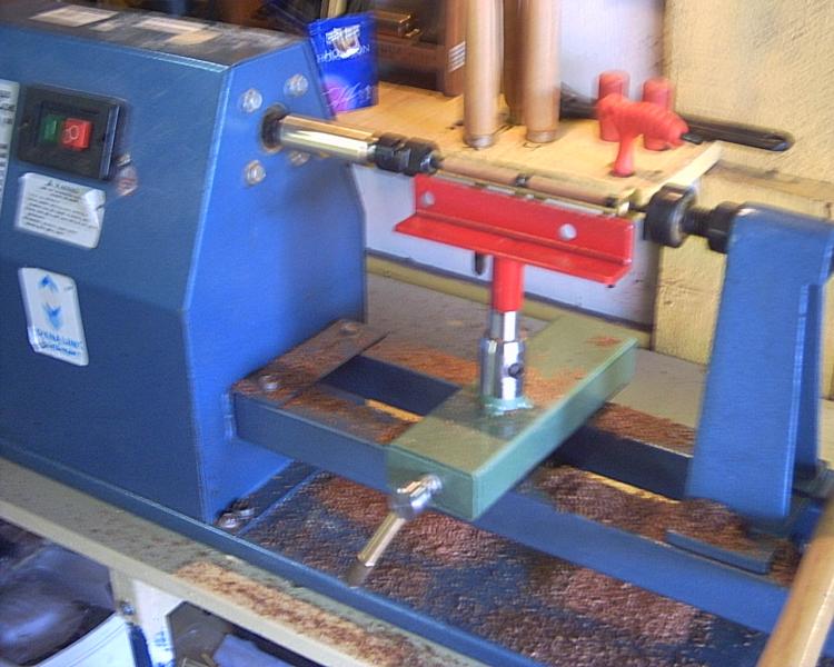

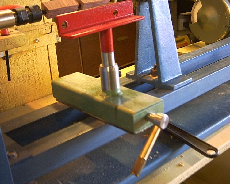

Before I got interested in wood turning ,I made a camlock steady rest for my metal lathe to test it out for wood, the old lathe was miles too slow for practical purposes so my first lathe was a cheap sheetmetal heap of junk , I did about a hundred slimlines and the proceeds from sales allowed me to move up a little in gear , but the camlock went over to the wood lathe no problem :) heres a picture of the rest I made ,and my first pen just starting to turn from square . A pretty straight forward and effective project . You may find you need a short tool rest to get in close to your centres if you turn that way . Cheers ~ John ,however you do it enjoy and have fun .:biggrin:
