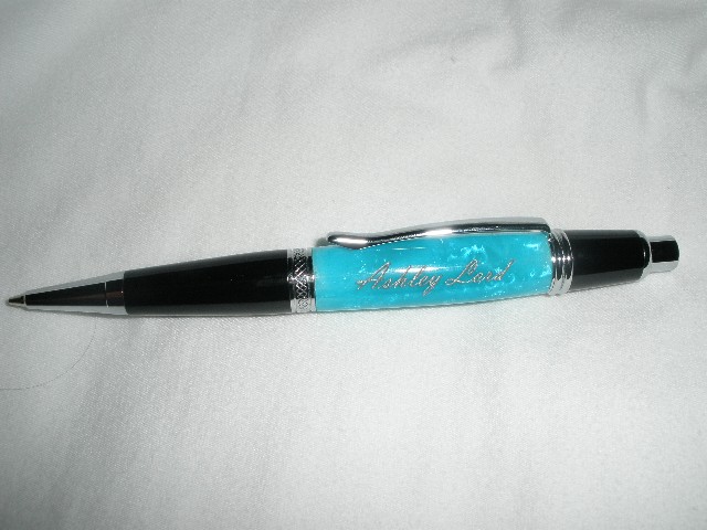

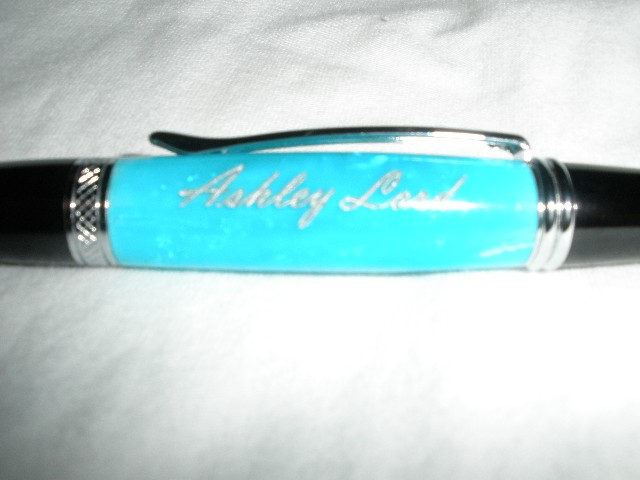

Hi Brad, The guy who does t he lasering for me does the pen after the finish is done. I fill with a high gloss acrylic enamel paint from Liquitex. Something like silver might be a good color. Here is a picture of an acrylic pen. I finish wood pens with CA & he lasers than when finished also then I fill. You could go back & apply more coats of clear over engraving.
