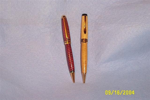

You might be selecting cobs that are too small in diameter.
You want a cob with a "pith core" about the same diameter as the tube in your kit.
No 2 cobs are alike so it's hard to tell you the exact size.
These aren't manufactured blanks so there are a lot of variables.
THat's where improvizaton comes in.
I included a picture of a Euro Style and a Perfect fit,
Both require either a tenon or parting off the cob.
(That gets a little scary)
