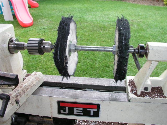

Here is my setup. Costs under 5 bucks to make the shaft, the wheels are about 3 dollars to 5 dollars a piece at HF or lowes.
Note the wheels are black as they are the ones I use for aluminum. I have a few sets of different wheels for different applications. (Aluminum, another set for brass, and one for wood / plastics).
Cheers,
Fangar

Is there an inexpensive way to make a separate buffing setup so you don't tie up the lathe? I'd like to keep the lathe free for turning the next pen while using a separate buffing system for turned barrels. Sort of like an assembly line approach, I guess.

I have a couple of homemade buffers like fangar just posted...one for wood/plastics and one for the brass cartridges I make pens with. I buff with a brown buffing compound called tripoli. Its grit equivalent is somewhere close to 2400MM or so. I do a second buff with a white compound called white diamond which is a white jewler's rouge. HF and the box type home centers carry a good variety of buffing compounds. I do a final buff with HUT Ultra Gloss Plastic Polish and then TSW. I have become a real fan of TSW in the last few months. I like it much better than RenWax. Some use an automoble swirl remover cream made by McGuires. The name is McGuires Scratch X...fine scratrch and swirl remover. I also have a second minni lathe that I leave the buffing wheels attached to most of the time. Although it is no big problem to remove the mandrel and mount the buffing wheels. I did that a long time until I obtained the second lathe.
I also have a buffer I made from a two wheel grinder. We have a store here called...Big Lots. The have a grinder for $19.95. I removed the wheels, added a couple of arbor extenders and put buffing wheels on the extenders. The extenders were $5 each from WC...Lowes or HOme Depot did not have them in the 5/8" size, just 1/2".
I also have the buffer from PSI and wish I didn't. I should have read more. It looks big in the catalog, but the wheels are only 4" wheels, or maybe smaller. I wish I had that money back.
