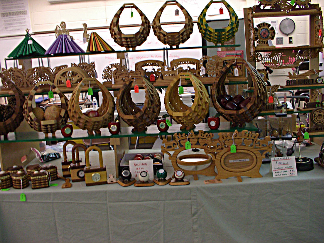

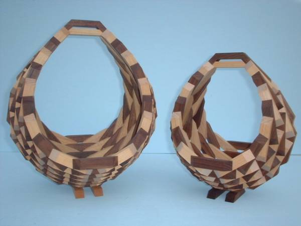

It is a good idea to seal the basket and the use of shellac will work well. I happen to dip mine in Danish Oil which has a small amount of Poly in it to seal the woods. But again as I said when people ask about using to store reall foods in them I suggest a seperation with a cloth or as Hank linked some dollie. Here is an example of my baskets which I have shown here before. They are designed to be center pieces for tables. You can see I display some examples of what people can use for. This is a photo of a set up at a craft show recently.
