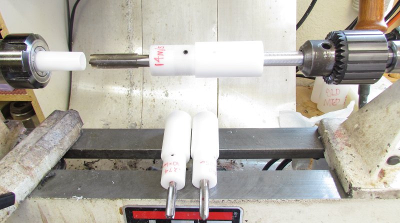

Last year I made a die holder from delrin and it worked pretty well. After using it for a while I realized that I could do something similar with a tool to hold taps so I made a few of them, each holding my most commonly used taps.
While not as sophisticated or as heavy duty, it is along the same lines as the one Danny showed above in that it rotates on a shaft and can easily be advanced into the part being tapped and withdraw very quickly by just spinning the holde on the shaft.
Tapping ebonite, acrylics and alumilite for pen parts, I do all the tapping by simply turning the handle with my hand. If you are tapping aluminum, drilling a hole crosswise and adding a small Tommie bar would help.
Mine rotates on a 1/2" shaft that chucks into a Jacobs drill chuck mounted in the tailstock.
You can make these tools from delrin if you have it or wood such as hard rock maple or even aluminum.
Because the diameters of the tap shanks vary, I wound up making a holder and drilling the hole for a snug fit of each tap then using a set screw to keep the tap from spinning. A side benefit is that I don't have to change out taps when I need a different one, I just grab the holder ready to go.
Here's a shot of what I did.

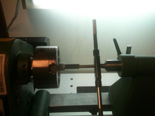

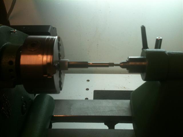

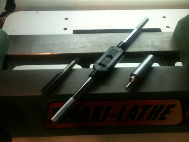

Excuse the cell phone pictures, my wife was using the good camera.
First picture is the tap inplace with the tap guide.
Second picture is the same as above but with the tap handle inplace.
Third picture shows the tap, tap handle and tap guide.
To use the tap guide put the tap in the tap handle and rest the tap at the end of the hole, slide the tail stock with the tap guide so the point is near the tap and then lock the tail stock and advance the quill to depress the point (~1"). The tension on the point is consistant and relatively light, just enough to keep everything in alignment. Then rotate the tap handle to start tapping.

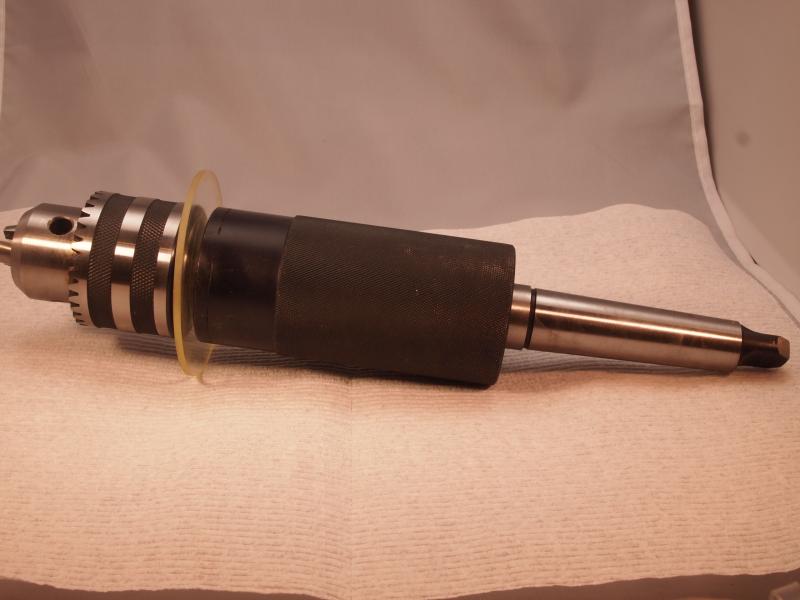

Unit I made
Here is the tool I made a long time ago, the knurled sleeve has both linear, and radial bearings, so it can slide and rotate, I have a return spring built into the unit so it has a slight return preasure on it, you just put it in the tail stock, and put the tap in the chuck and slide it forward into your part to stop cutting let go, and it spins with the lathe.
Like I said I don't use it that much any more, works great for small production runs. :biggrin:
