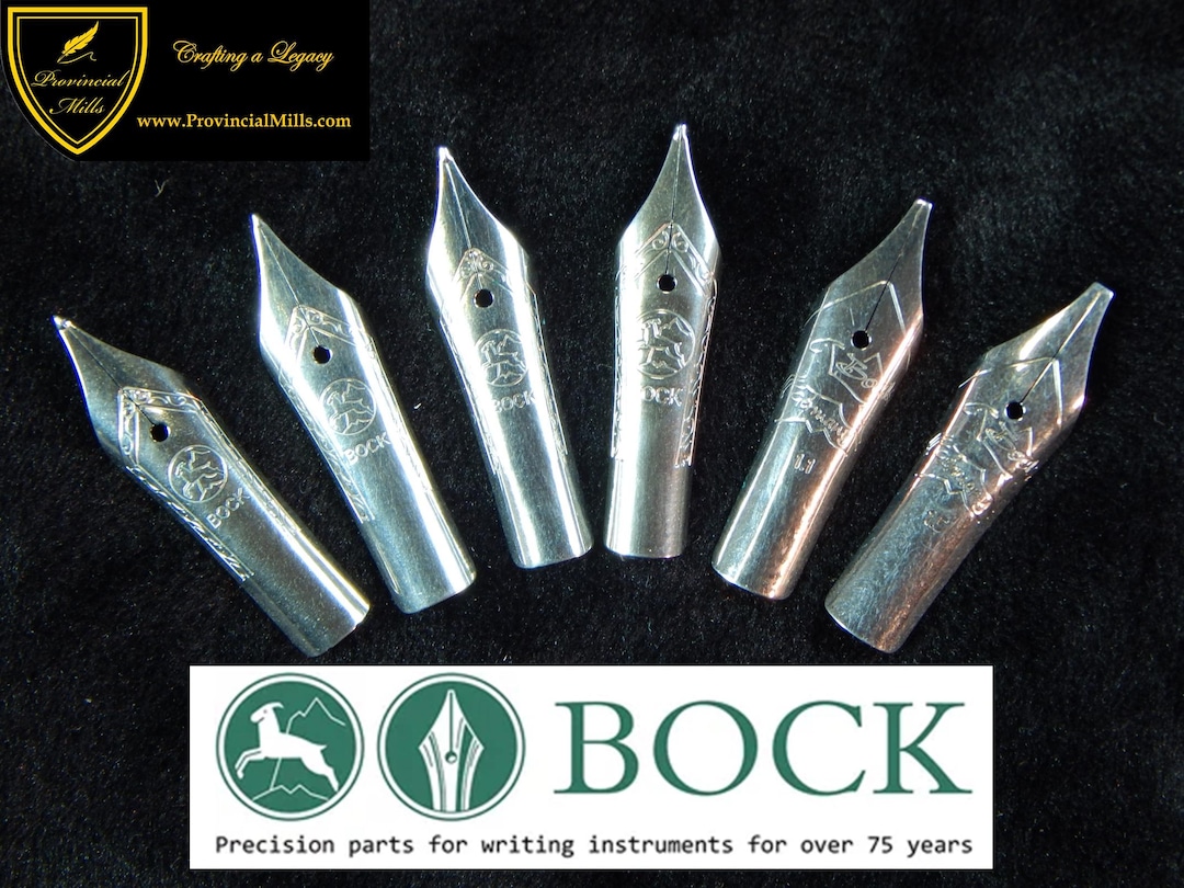

I am new to making fountain pens and have a question about replacement nibs. I'm currently making two Jr. Emperor fountain pens, which come with a medium nib. My daughter prefers a fine nib, which I would like to provide for this pen. Are there quality replacement nibs for the different fountain pen kits?
Thanks for any assistance you can provide.
Jim Smith
Yes.
I just experimented. The section and nib assembly of the Jr. Emperor are both swappable with the section and nib assembly of the Leveche fountain pen from Beaufort Ink. I was a bit surprised, did it again, same conclusions.
Which means a Bock standard size 5 nib (type 180), with the Bock housing, nib color/finish, and point width of your choosing, will be compatible with the Jr Emperor.
The only place I know that sells all the options is Beaufort Ink, Turner's Warehouse only has size 6 listed on their site.
