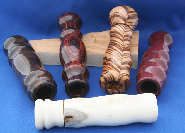

Sometimes I use wax and sometimes I don't. So far I have buffed lightly only a couple of items at the most. The real process of making something shine is not due to the waxing and buffing per se, but the workmanship put into the finish itself. If waxing and buffing makes something shine more than it was before, then the finishing techniques prior to the buffing and waxing are probably lacking.
Below are two links of mine in which I did not buff at all and did not wax on the duck calls; I did on the pen. Neither were buffed.
http://www.penturners.org/photos/images/940/1_Best_pen.jpg
http://www.penturners.org/photos/images/940/1_5_Duck_Calls.jpg
The point is that when properly finished, buffing and waxing are extra steps that may or may not add anything to the end product. Focusing on the finish itself will lay a better foundation for the buffing and waxing - to the point that they may not be needed in some cases.
