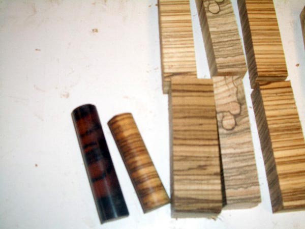

I also turned a crosscut Mac Ebony and Zebra and they are harder but doable. I like the grain!
Great shimmer, you can't see in the pic.
