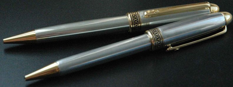

My first two and only two aluminum pens were drilled with a brad point bit. It would not have been my first choice but it was the only 7mm bit I have. It worked.I drilled it as if it were a piece of wood nothing special. Drilled on the drill press with the blank held in a pen vise. I should correct that "nothing special" statement. Whenever I drill any of my blanks I use a steady stream of air directed into the hole with a rig I set up. I feel this keeps the blanks and bits cool to prevent break out and other drilling problems. Of course I cleared the bit often as the chips cling to the bit.
