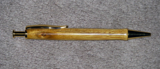

I think this is the least metalwork click pen out there .
It really shows off a great blank .
