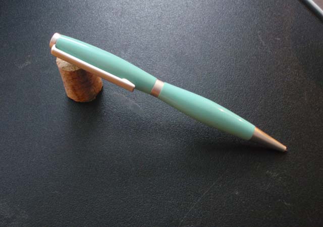

Commercial sewer or water pipe comes in a heavier gauge like 3/8 or more and you use it just like a pen blank.
Lin.
They use large diameter PVC that is at least 1/2 thick the green /purple colors are from the type of use the pipe is intended for. Usually they get it from an acquaintance that is a plumber on commercial jobs or from a job site that is throwing away cutoffs. I think Lowes and HOme Depot both carry a pvc wood grain trim piece. Its 3/4 to 1 in thick I dont know how it would work.
Here is a blank I got from bruce119.
Lin.
