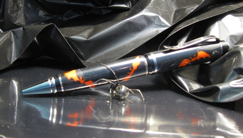

Not to hard to get the thick wall stuff. Go where they are putting in a new housing development and ask for some scraps. I needed some black once to make a Halloween pen. Couldn't find that in thick so I took DWV pipe. Cut strips of it and glued it together. It worked fine. Mad this pen that way:
