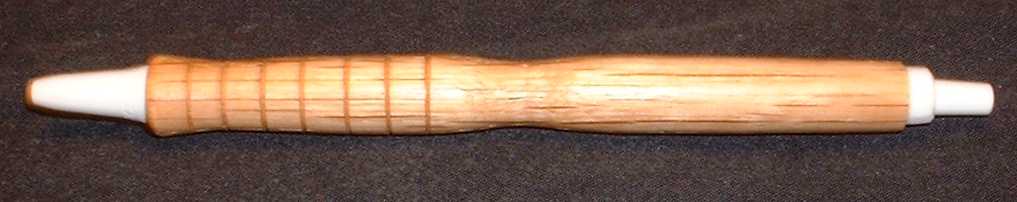

I've never much cared for the click type pen and can operate any of the ballpoint pens I make with just one hand. I can't get them into action as quickly as a click pen, but they can be operated with one hand. I don't know what it would be like if I had arthritis though.
Something like that? No, it's not mine.

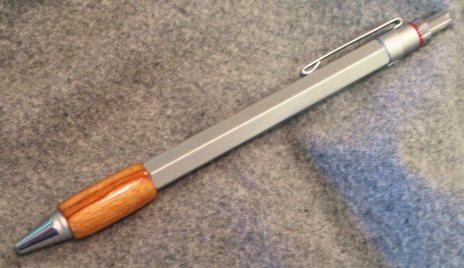

I also have been looking for a good click pen, but I took a different approach. I bought a Rotring Silver 600 ballpoint from http://www.dalyspenshop.com/ The finger grip area is too small for me so I added a sleeve of tulipwood.
<br />
Now it's a comfortable pen, and I like that it uses Parker refills.
Looking forward to your comments, good or bad.
