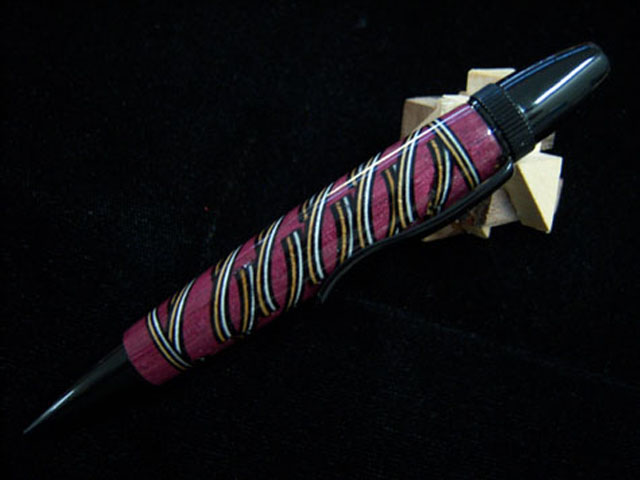

Purple Heart with Veneers on a Bright Black Atlas Kit. All comments welcome. Thanks for lookin'.

Yeah, I made the blank.
I saw some of your work and I think it is all pretty cool. I tried to use aluminum and then copper like you did and it ended up ok but I had a hard time combining the different materials with wood. What do you use for adhesive? I tried it with medium ca and they kept comming loose.
Typically I use the Heavy CA when gluing pieces together. Be sure to scuff your metal pieces first for better adhesion. Also, as you sand or drill the blanks they absorb alot of heat, especially with the metal in there. I've noticed a tendency for seperation when they get too hot, so take your time. If nothing else, in dealing with these metals I am getting a great lesson in patience which I know that I definitely need. Lately I've been wrapping the blank in clear packing tape before drilling. Seems to help.
On the lathe, take your time. Keep your tool sharp and take nice light passes. Again, PATIENCE! You are not going to set any speed records taking this blank down. Watch how much you are taking off the whole pass, as the blade likes to find softer material and then will catch on the metal, leaving you looking for a piece on the floor to hopefully glue back on.
Hope this helps, if you have more questions let me know. I'll be happy to answer them. :smile:
Thanks Steve. That is exactly whats happening. It was heating up fast and seperating. I will take more time now and I will also try the packing tape idea.
