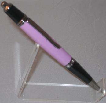

A friend gave me a section of Purple PVC water pipe. I finally got around to cutting a piece out today. My niece is going to get a nice surprise in the mail next week. Purple is her favorite color! My wife saw it and now I've got to cut some more blanks out. For those wondering what Purple PVC pipe is for it's for "reclaimed water".

Nice shade of purple, more like a light violet. I've only seen green and blue in the PVC so it's great to see it comes in other colours as well.
A wonderful job on the pen, your niece will love it!!
That's pretty cool. My grandaughters would love that.
Would you mind explaining what do you have to do to the pvc and how you finished it?
Actually turning PVC is just like turning acrylics. A little harder but not quite as hard as Trustone. Almost like turning Corian. After turning to shape then I wet sand to 12000mm and then use HUT Plastic Polish and buff it out at high speed.
As soon as I can take the time to cut up this pipe, it's 3/4" thick 16" diameter, and 32" in length, I'll offer some up. First thing was to cut a piece out and see what the end product would look like. I was definitely happy with the outcome.
