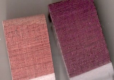

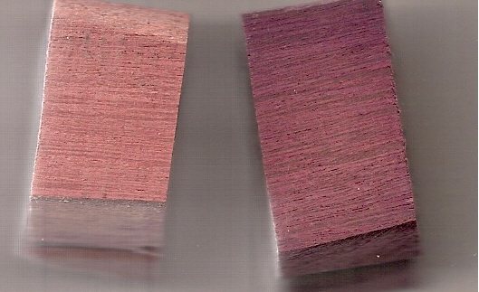

I did the oven method. Here are before and after scans (after is on the right).
Fifteen minutes at 350 degrees:
and anotehr ten minutes at 350 degrees:

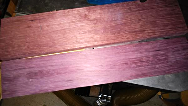

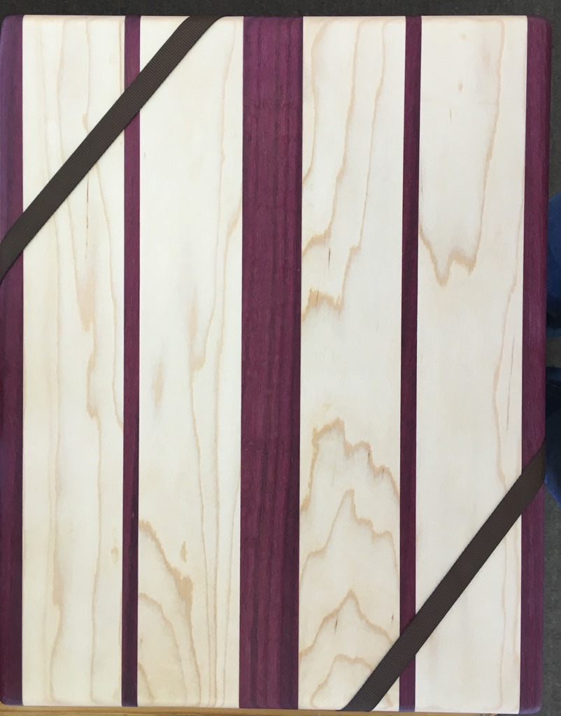

I just completed a cutting board with maple and purpleheart. When completed, the purpleheart was brown. I remembered light helps so I put it in the sun for about 20 minutes flipping it over at ten. It turned purple. After Howard's Butcher Block Finish it looked wonderful.
Try sunlight!
Purpleheart is deep purple and beautiful
Here is a quick photo from a phone. The ribbon is used to hold item information, care instructions and the price. Better in person.
It was brown like walnut/cherry mixed together before sun treatment. I've used this a few times and seen it happen often to fishing lures trolled in the sun behind the boat. The purpleheart gets more purple, for a while... Everything colorful goes brown after time.
That is a beautiful cutting board. It looks amazing. I love what happened with the purple heart after a little time in the sun.
