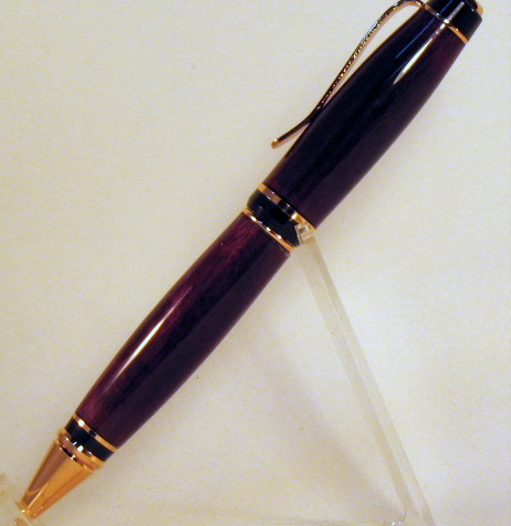

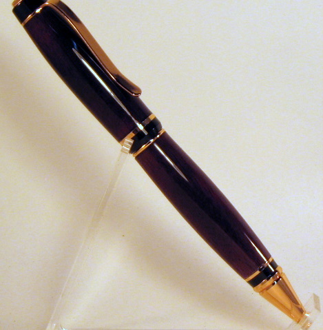

Thanks you guys !! I told Susanne about my dilima and told her I needed to put the blanks under some heat , like in an oven . She said "whos oven are you going to use?" :redface: So , I got the idea to light up my propane heater in the shop , and put the blanks over the heat , and rotated them once in awhile . In about ten minutes they were purple . Thanks for the help my friends !!

man dude thats the deepest purple i've ever seen. oh and you could just get a heatgun from HF for like 10 bucks
