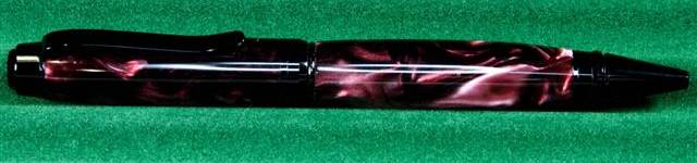

This is a Purple & Black celluloid Cigar pen from CSUSA. Its finished with a Hut plastic polish. Thanks for looking!
Very nice RT. Great looking resin, I like how it transistions to an almost all black cap.
Very sharp, good one!
That is absolutely excellent! Looks like a great finish! How much sanding and what kind of grits did you use? I'd really like to try these when I have a little more time at the lathe.
Nice pen, thanks!
Thanks everyone, appreciate all the comments!
Michael, after turning I wet sanded with 320 real light and then switched over to MM from 1500 to 12000. But starting with the 1500 I used the hut polish to sand with through the first four grits and that seem to help a lot with small scratches, or I just got lucky, who knows? [:D]
